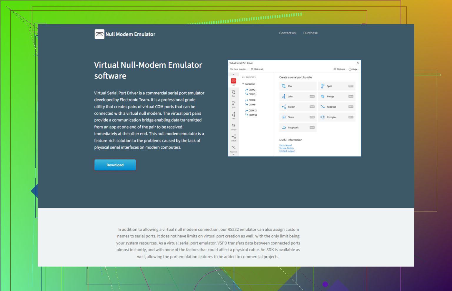

Hey, for anyone trying to wrangle virtual serial ports on Windows… I’ve been down that rabbit hole before. You’ll see folks mention com0com because, well, it doesn’t cost a dime—and yeah, it works for basic setups. But let’s keep it real: wrestling with unsigned drivers and sketchy documentation can really kill your vibe, especially on newer versions of Windows.
Now, if you want a headache-free setup with more bells and whistles than you’d expect, you might want to check out Virtual Serial Port Driver. I threw it into my workflow after wasting hours fiddling with registry hacks and ghost ports. Night and day difference! Not once have I gotten stall-outs, resource hogging, or ghosted COM ports since the switch.
Honestly, if you’re doing more than just casual experimentation, having a tool that “just works” saves a ton of time you could be spending actually building and testing your project. If anyone’s got a secret, bulletproof open-source alternative that feels as polished, hit me up, because I’ve been hunting and haven’t found one yet.

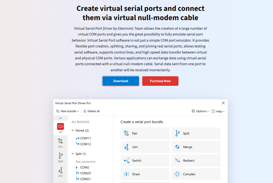

So I caved and went premium with this virtual COM port solution for reliable Windows 10 null modem emulation. What a relief. UI isn’t from 1998, pairing/unpairing is click-and-done, and you actually get real support if you hit a wall. Downsides? It’s not free. But for real dev work or stress-free testing, it’s the closest thing to plug-and-play you’ll get.
If your budget’s zero, try com0com until the headaches eclipse your savings. Otherwise, do yourself a favor and use something stable like Virtual Serial Port Driver. If someone claims a flawless open-source option for a virtual null modem cable that doesn’t break with every Win10 patch, I’m all ears. Prove me wrong.
