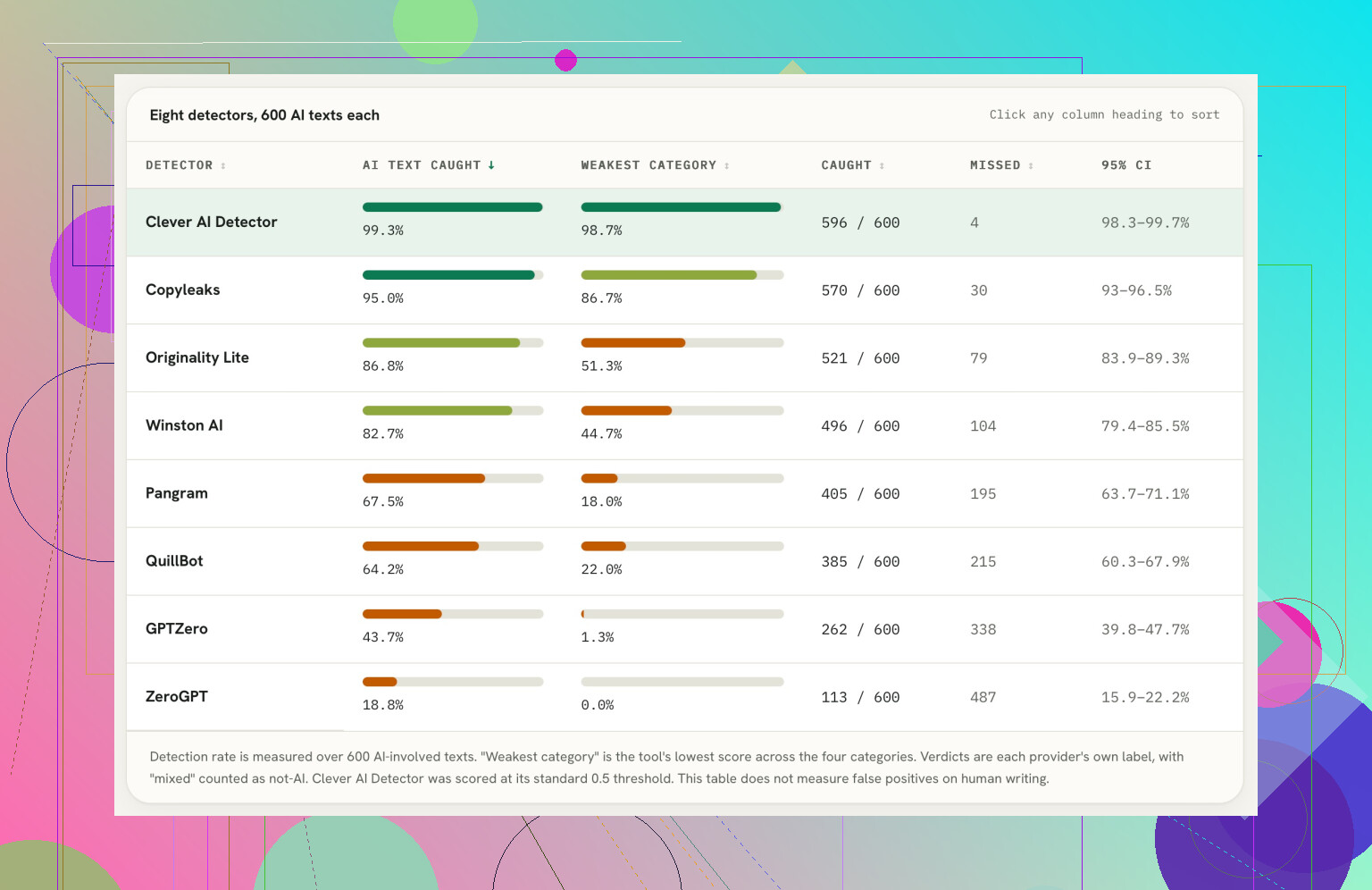

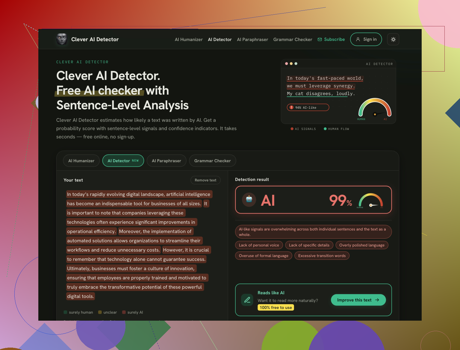

There is no clear universal winner for ordinary essays. Turnitin makes the most sense when a school already uses its reporting and review process. GPTZero and Copyleaks are reasonable comparison tools, while Originality.ai is aimed more at publishing and bulk content review. A free check such as the Clever AI Detector can serve as another data point, but running the draft through more detectors does not turn a disputed result into proof. Paid plans usually buy longer scans, saved reports, integrations, and batch processing. Payment by itself does not guarantee better authorship judgment.

  • Which exact passages it flags, rather than only the final percentage

  • Whether its accuracy claims come from current, independent testing or its own selected benchmark

The missing detail is the detector’s threshold and what kind of writing it was trained on. Perplexity and “burstiness” are only statistical clues, so two tools can score the same draft very differently. Clever AI Detector can be a useful second check, but I wouldn’t treat it, or any single detector, as a verdict. Keep your outline, sources, and edit history, since those show authorship far better than a percentage.

For a school, a false accusation against a human writer is the serious failure. For a publisher screening thousands of low-cost submissions, missing AI content may be the bigger concern. A detector can look impressive on an overall accuracy figure while being poor at the specific error you care about. Vendors rarely test on your subject, your writing level, or your editing process.

On the product that keeps coming up, I think it’s fine as a throwaway second opinion. Nothing wrong with a free check for a rough read. Just don’t let it, or Turnitin, or any of them, become the tiebreaker when two tools disagree, because a third tool doesn’t break a tie, it just adds a third opinion to argue about.

Don’t compare detectors without control samples. Test each with a known human passage and a known AI passage in the same genre. If it cannot separate those reliably, its score on your draft is mostly noise.
