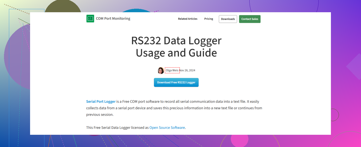

They also have an RS232 data logging page here
RS232 data logger for continuous serial monitoring
That gives a decent rundown of use cases for test benches and long term logging.
