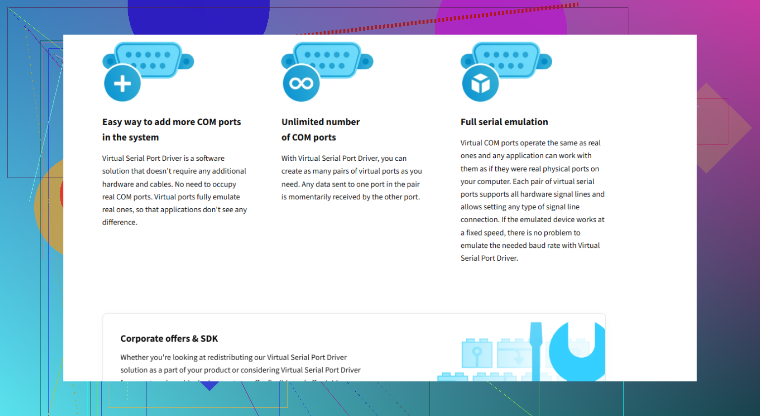

When You’re Stuck With Just One Serial Port…
So picture this: you’ve got a device hooked up, and your trusty computer only offers a single serial port. But life throws you a curveball—you actually need that same stream of data to feed another program at the same time. Ever been there? Yeah, it’s awkward.
Let me save you hours of frustration: check out this serial port emulator. Seriously, with tools like that, you don’t have to scrounge for old adapters or swap cables mid-session. It’s like a “clone” button for your port—virtual ports get spun up, letting separate apps listen simultaneously without stepping on each other’s toes.
No wiring. No risk of Windows flat-out refusing to play nice. It’s made my test setups so much smoother, especially when logging and analyzing in two different pieces of software. Give it a try if you’re done with cable yoga.
