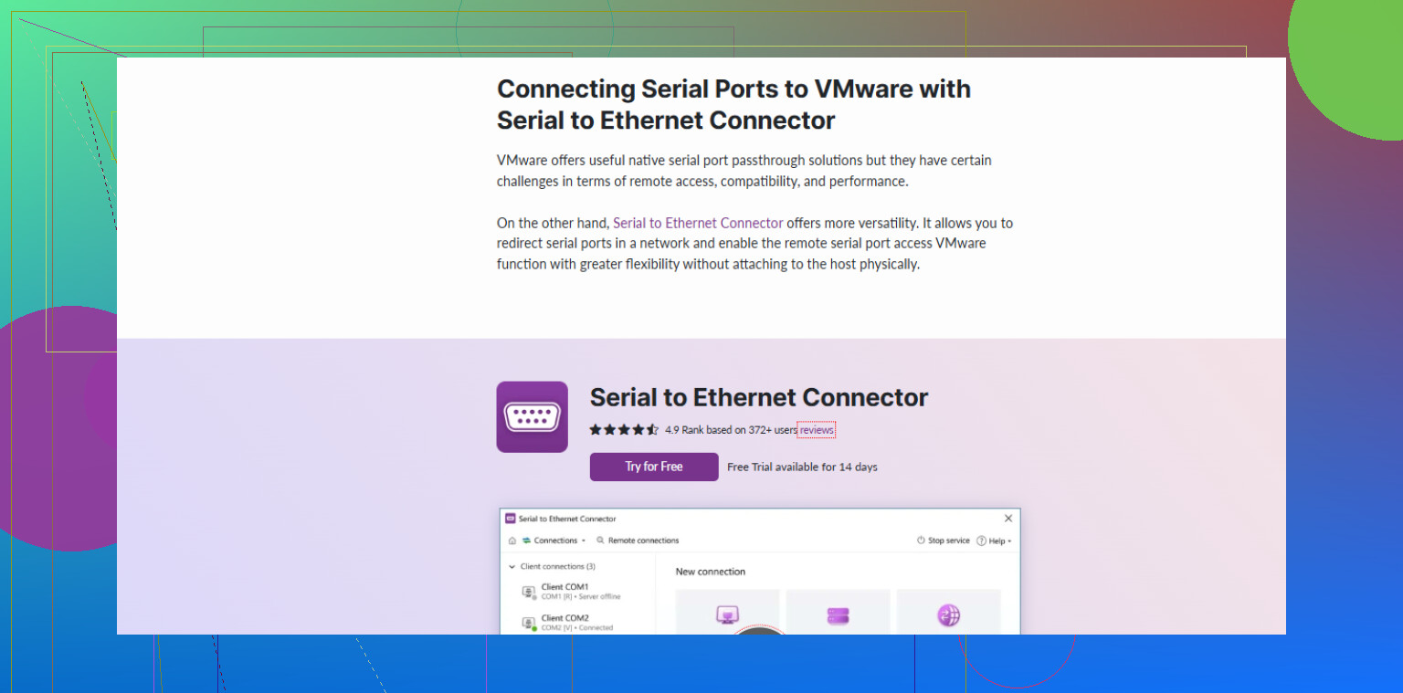

    This is where a tool like Serial to Ethernet Connector actually makes life easier. You install it on the host, share your physical COM port over the network, then the guest connects to it as a virtual serial port over TCP. It avoids some of the low level VMware quirks and can be way more stable, plus you can even share that same serial device across multiple VMs.
  7. More detailed how‑to
    If you want a step by step walkthrough on integrating a VMware serial connection inside your virtual machine, that guide covers config examples and some of the edge cases.
