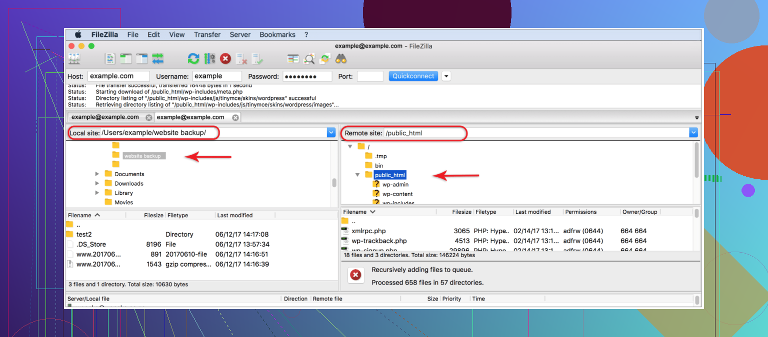

Step 2: Upload the files via FTP
This is where you’ll need an FTP client. You connect to your server, navigate to the root directory of your domain (usually public_html), and upload everything. One important thing: don’t upload the wordpress folder itself. Go inside it and upload the contents. If you upload the folder, your site will end up at yoursite.com/wordpress instead of yoursite.com, which is probably not what you want.

FileZilla is the one most people start with. It’s free, runs on Windows, Mac, and Linux, and does the job for everyday tasks. The downside I’ve personally noticed is that it slows down quite a bit when you’re dealing with large files or uploading a lot of them at once.

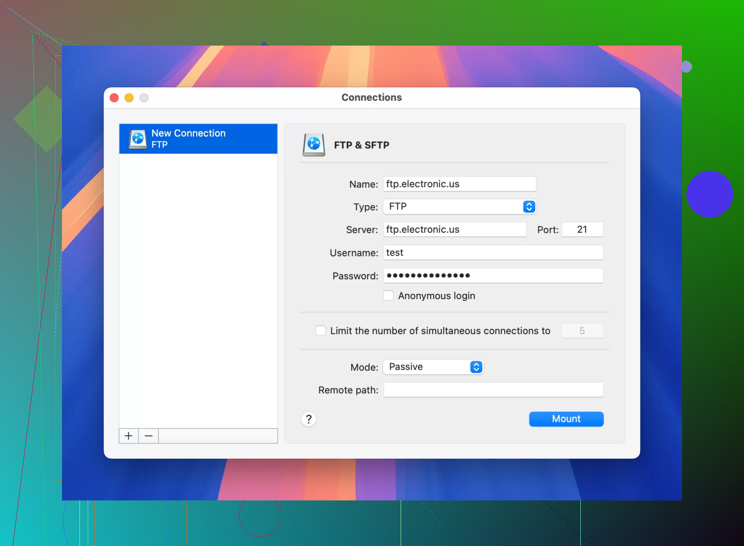

Commander One is what I’d suggest for Mac users. It’s paid, but it comes with proper FTP/SFTP support, handles archives natively so you can compress files before sending them to the server, and has a dual-panel layout that makes file management much less painful. If you’re doing development work regularly, it’s worth the cost.

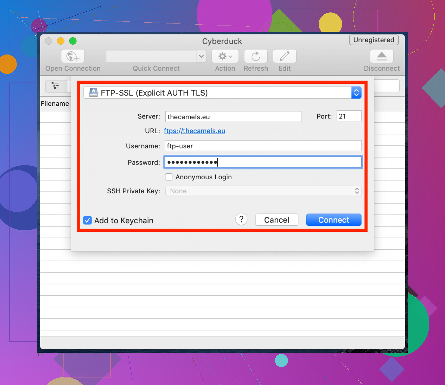

Cyberduck is free and open-source, which sounds great on paper. In practice though, a lot of users (myself included at one point) run into weird issues with basic stuff like renaming or moving files. Usable, but a little unreliable.

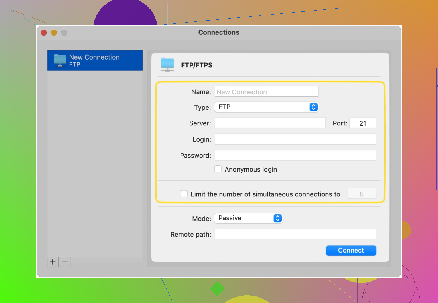

CloudMounter works on both Windows and Mac and takes a different approach entirely. It mounts your FTP server as a local drive, so you browse it straight from File Explorer or Finder like it’s just another folder on your computer. If you’re newer to all this and a traditional FTP interface feels confusing, CloudMounter is probably the most approachable option.

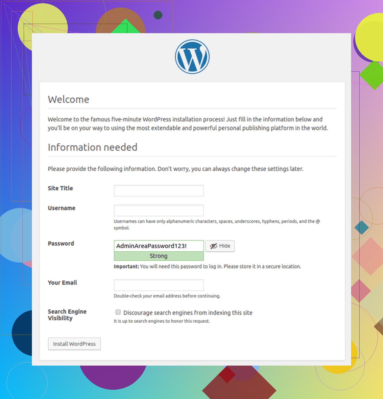

Step 5: Create Your Admin Account
The last screen asks for your site title, admin username, password, and email. Fill these in carefully and save them somewhere. This is how you’ll log into your dashboard going forward.
There’s also a checkbox to hide the site from search engines while you’re setting things up, which is handy if you’re not ready to go live yet.
Click install, and that’s it. You’ll see a success screen with a login button.
